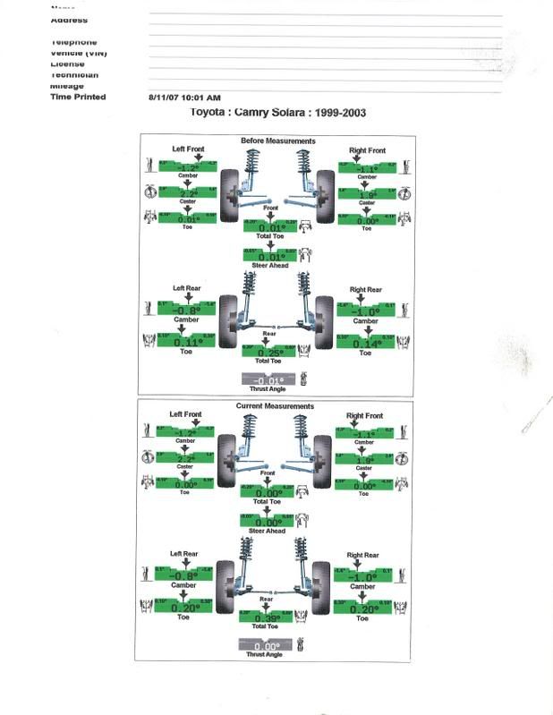

Postby Solorange » Mon Dec 17, 2007 4:54 pm
Well here is the data sheet they gave me when I got my car back from the alignment. Do any of you guys see any problems? Everything is green which means its in spec supposedly. Red is bad. This was from getting the alignment a second time this past summer. Again the first time was two years ago after I lowered my car.
Postby TadS » Mon Dec 17, 2007 5:38 pm
Looks like the ones from our machines. It’s in, but man is that close. How was the fuel load in it when you had it aligned? If you had like a half-tank, or less your probably out with the full load. Also, if you’re big guy, you get a couple of people in there, or pick up some cargo, you’ll probably drop out. It’s not “out”, but it’s so close it wouldn’t take much to cause it to go out. I would see if you can get them to bump it closer to 0.

Postby CamryOnBronze » Mon Dec 17, 2007 6:10 pm
does that say 2 degrees of camber in the front? I would think thats way too much...
Postby Solorange » Tue Dec 18, 2007 5:13 pm
TadS wrote:Looks like the ones from our machines. It’s in, but man is that close. How was the fuel load in it when you had it aligned? If you had like a half-tank, or less your probably out with the full load. Also, if you’re big guy, you get a couple of people in there, or pick up some cargo, you’ll probably drop out. It’s not “out”, but it’s so close it wouldn’t take much to cause it to go out. I would see if you can get them to bump it closer to 0.
Are you talking about the Camber or something else?
Camry on Bronze the driver front says -1.2 and driver right -1.1. Your looking at the Caster
Postby TadS » Tue Dec 18, 2007 9:28 pm
Hehe you're right, I am gonna blame the pain killers. Sorry about that...
TadS
Posts: 1445
Location: The Hoosier State
Postby Solorange » Fri Dec 21, 2007 3:39 pm
TadS wrote:Hehe you're right, I am gonna blame the pain killers. Sorry about that...
Ok Im confused now... Is my camber just inside the spec or where you also looking at the caster setting thinking it was my camber setting.
