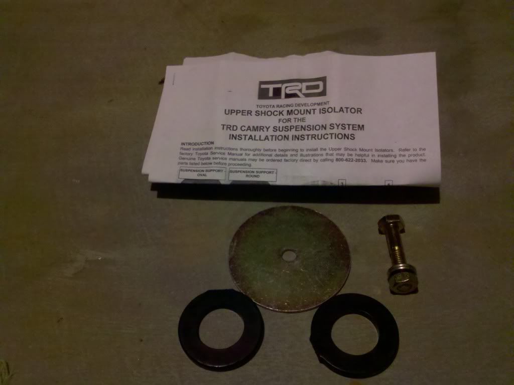

Postby mdatrdcam » Tue May 03, 2011 9:13 pm
Ok so here are the pictures of the TRD vibration isolator kit I promised to take. If someone would like measurements of any of the pieces, feel free to let me know and I'll take them for you. I can take pictures of the rest of the TRD instruction manual if anyone wants them. There may be a way to replicate it, but the black pieces are rubber and I don't know how you would get that done

Postby Gregtrd » Wed May 04, 2011 12:33 am
can you post the rest of the instructions? that almost looks like it replaces the bearing with a all rubber insert, can you post better pics of that insert.

Re: Vibration isolator?
Postby 02slera » Wed May 04, 2011 3:07 am
Anyone could replicate the installation tool.
the exact dimensions of the insert and instructions are what someone would need to make their own.
though i dont think anyone will, the struts themselves are discontinued.
looks like its just a peice of rubber that gets pressed into the stock mount, but the rest of the instructions would verify.
