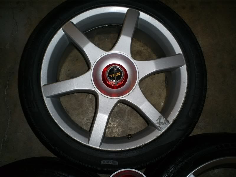

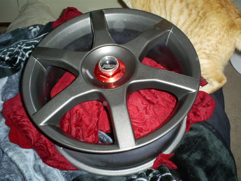

Postby NRDriver » Sun Mar 15, 2009 7:29 pm
i thought it was time for a facelift for the revos. i am gonna just sell em but i figured i could get a bit more for the if they looked a bit nicer.
before

Postby SpeedySolara » Sun Mar 15, 2009 9:34 pm
What paint did you use? And what did you use to cover up the imperfections? Its really shiny and looks great.

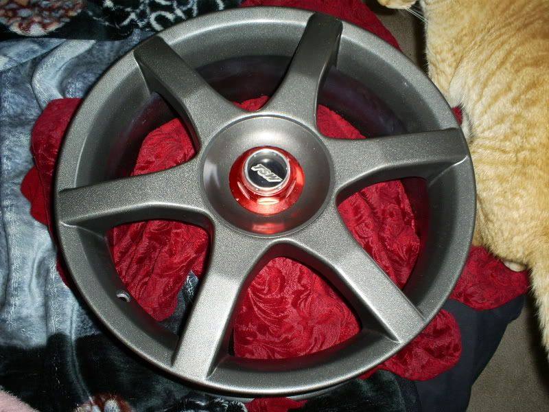

Postby NRDriver » Sun Mar 15, 2009 10:36 pm
i filled the scratches with a liquid metal and sanded with 80 grit. sanded with 400 and then primed with duplicolor primer. followed by 800 grit. used duplicolor wheel paint (2 layers.) followed bye some buffing. and for the clear coat i used duplicolor clear laquer. in between each of the 3 coats i buffed it out.
