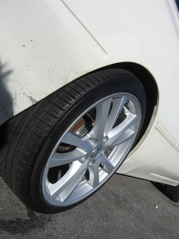

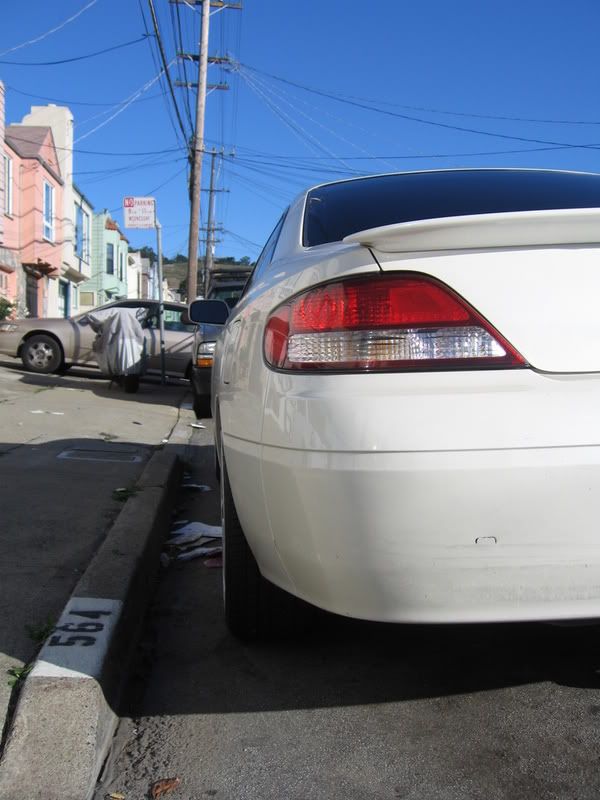

Based upon this picture, what size spacers would you all say I should get to bring the rear wheels out to a good looking distance. And yes, I know I need to get it dropped :roll: Thanks for the help.

i think the wheels look fine just the way they are.....just lower it and you will be all set!

Postby akora12 » Tue Jan 08, 2008 9:43 am
I think that would be hard for anyone to specify visually. I would do some measurements based on the distance from your tire to the inside of the wheel well.

Postby Toy1mzfe » Tue Jan 08, 2008 11:30 am
do you know the specs on your wheels.
we can set u up so that you are flushed to the fender.
but without specs and a drop you cant really determine it.

Postby Akfahad » Tue Jan 08, 2008 4:59 pm
SleeperSolara wrote:Lower the car first then think about spacers. IMO.
x2
you can also measure it, since the drop won't necessarily change the distance to the fender, measure from the outside of the tire to the fender in mm. my front was 12.5 (got a 10mm spacer) and the rear was 25 (got a 25mm spacer)

Postby Eye8Pussies » Tue Jan 08, 2008 10:01 pm
I'd say 10mm from here....but it's hard to say....10mm may rub, and you better get real spacers with longer studs as well....
5mm would help for sure, but it could sstill come out more imo
