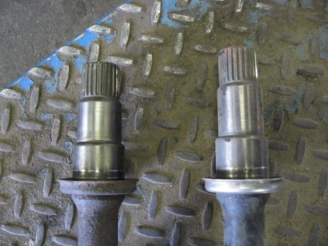

This is the reason why:
On the left hand side, you see the 5-speed passenger side half-shaft. On the right hand side, you see the automatic half-shaft. As you can see, the 5-speed shaft is noticeable shorter- about a cm.
And here is where the main difference is:
The length of the input shaft. We had actually figured out why the auto shaft didn't fit and ground it down (I didn't take pictures of what we did) and we got it pretty close to the shaft/size of the 5-speed one, but it was ground down to the point where there were barely any splines left and definately NOT safe for use.
On the driver's side, the automatic axle will be too short and will not "clip" into place. On his site, Jon said that they couldn't turn the differential at all with the auto shaft, but I was actually able to make the splines catch and turn, but it would have slipped out quite easily. So again- a no fit. And here is a visual reminder of why that is:
On the top you see the 5-speed axle and on the bottom you see the automatic axle.

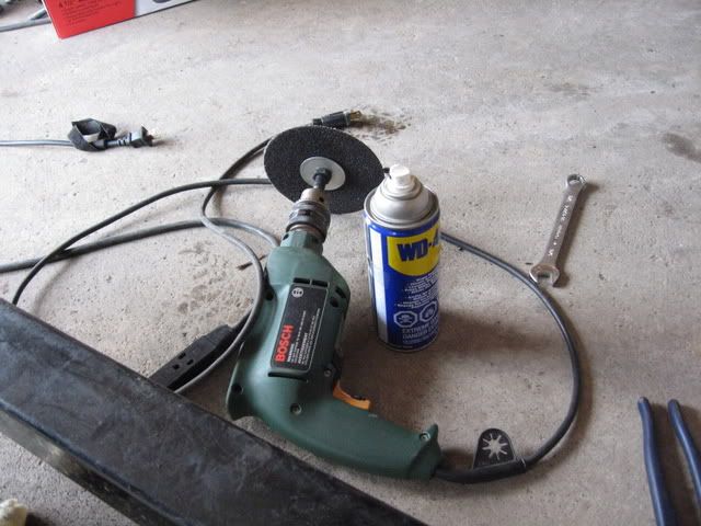

Removing the Bearing Mount
Due to the design of the half-shaft bearing mount and its positioning to the half-shaft head itself (where it meets the passenger side outside axle), it is basically impossible to reach one of the bolts that retain the mount to the engine block. This problem had me stumped for quite awhile until I figured that since I don't need my auto half-shaft anyway, I may as well cut it up. A cutting torch would have been handy, but my only option was to use a cutting disc + drill since my grinder couldn't fit a large enough disc. Here are the results:
In the end it really only took about 15-20min to get it done and then take the last remaining bolt off.
The frustrating thing is that according to the shop manual, you can just "slide" the actual half-shaft out of the bearing and its mount by unbolting its retaining screw, removing a clip and then pulling it out. Of course Toyota never thought about seizing/rusting, etc. Basically, once the car is driven, the shaft is then not removable from the bearing and its mount without a press :hammer:

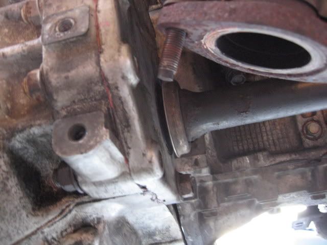

- As reported by people how have done the swap, the y-pipe flange is supposed to touch things, but mine luckily didn't. I don't know if it's because I have a performance y-pipe or not, but Ratko had the same y-pipe and his still hit, so it may be a case-by-case thing.

The last bolt on the passanger axle is tricky, but doesn't need to be cut. You just need to get a box wrench on it (can only get an angle on it, not real sturdy) and hope you get it loose before it strips... I got mine out twice, but it wasn't the easiest thing...

SC V6 -> yeah, it seemed doable at first because I was able to get the box wrench in there, but since it had been on my car for 13 years, it basically wasn't coming off without an impact gun hit straight on. I tried adding wrenches and everything for more leverage, but due to the angle of the bolt, it would keep slipping off. I had to make a decision about that bolt before I totally stripped it and even an impact gun with the head of the half-shaft off wouldn't get it off.
