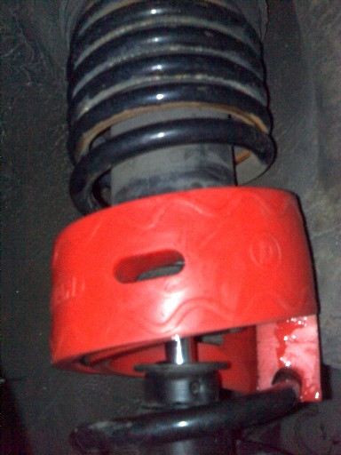

Ok all the above posts talk about something that goes in the strut mount. Makes sense, look at your strut mount and there's a huge gap between the rubber and the top of the strut mount where the rubber is inserted.
However, what throws me off is that superstreet talks about something that increases springrate. The only thing I can think of that would do that is this: http://www.zerotohundred.com/newforums/ ... 1211672930
But that doesn't get "inserted at the top of the mount". So is SuperStreet talking about 2 different things?!

Freakin eh... Alright, take a look at this pic. At the top of the spring, you'll see a 1" rubber block. That's the isolator
http://www.superstreetonline.com/projec ... to_11.html
What I don't understand is, the superstreet says it's "pinch the isolator while inserting at the top of the mount."
So what exactly gets inserted at the top of the mount?! I'm confused...
Plus, the isolator should be a component of trd springs, not trd struts. Or, are TRD struts shaft longer than oem? Again, only Greg can answer that one. Greg, wanna measure the length of a fully extended strut? I'm not sure why a longer shaft is needed in a lowered car?
