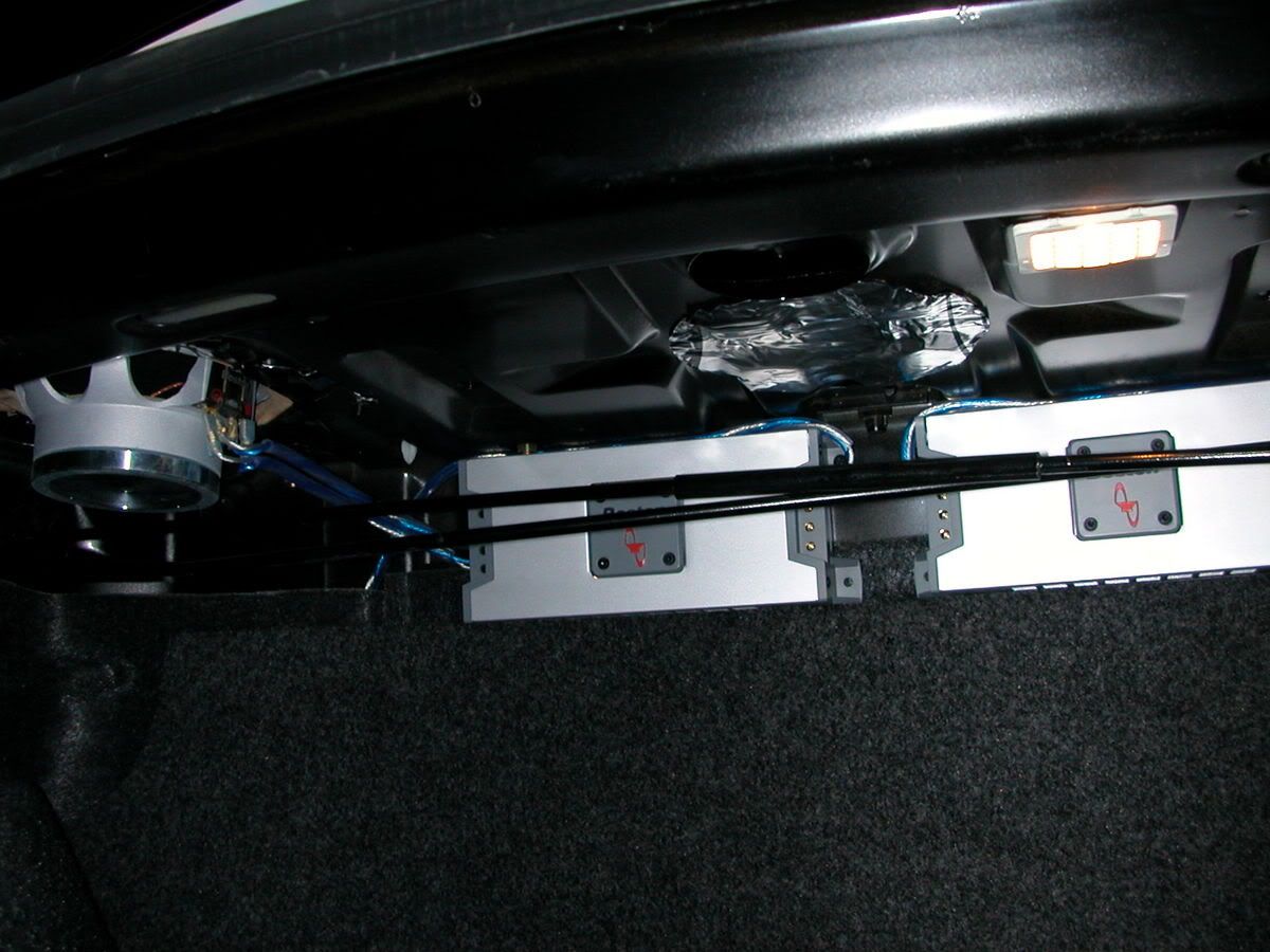

Postby theprodigy79 » Mon Jul 24, 2006 5:53 pm
Here's a shot of my spacer as well. I used 1/4" MDF in the rear to convert the space for a 6x9 into 6.5" round, and also to clear the magnet from the metal bars going across the trunk...

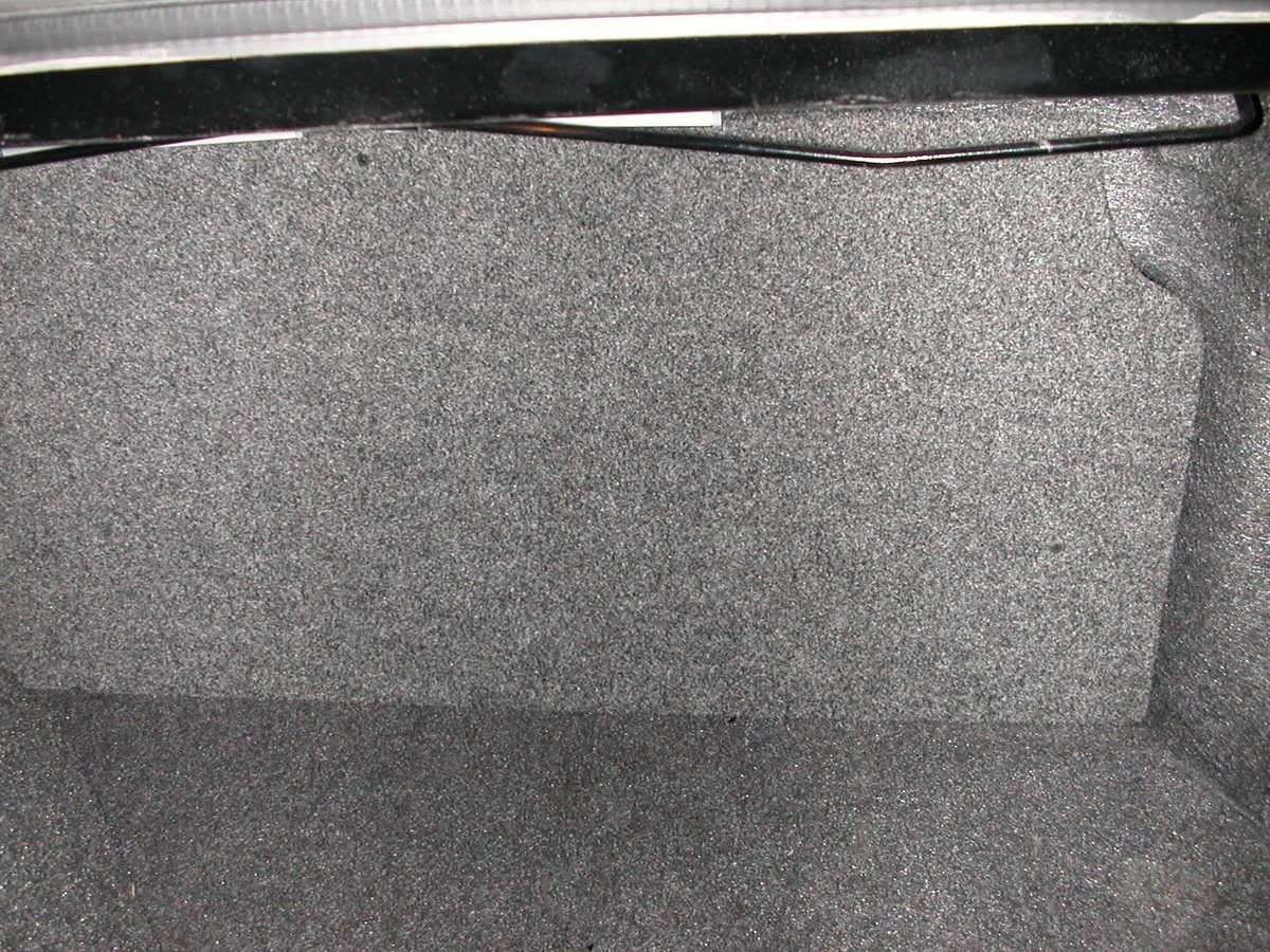

Postby theprodigy79 » Mon Jul 24, 2006 5:59 pm
Thanks dude, the Civic is clean as well :-) Seriously, I know what you mean... good installs take FOREVER! I had to retire my car for a full weekend soon after I first got it and rent a car in order to do mine :-P
Couple more shots:
What it looks like from outside the trunk:
You can kinda see the 6.5" in the door (Gen 2 comes with 6x9s up front as well):
