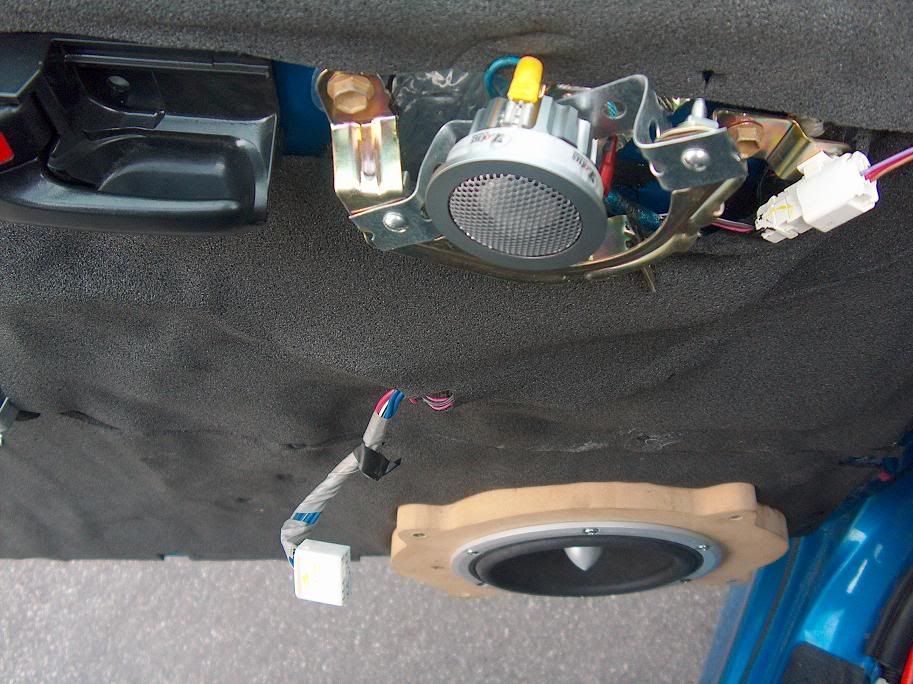

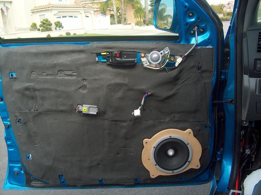

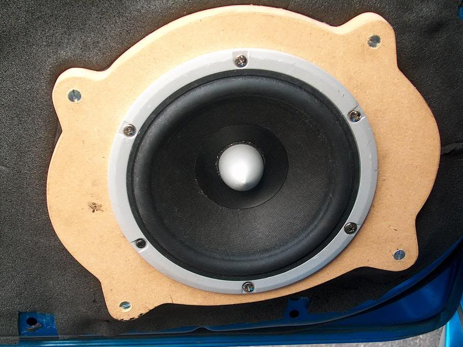

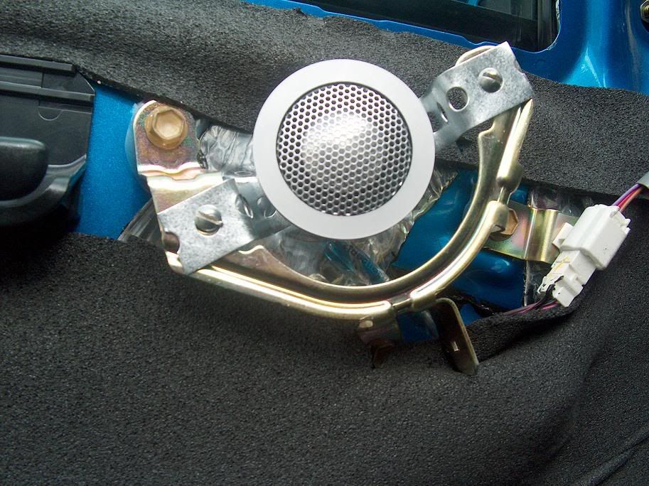

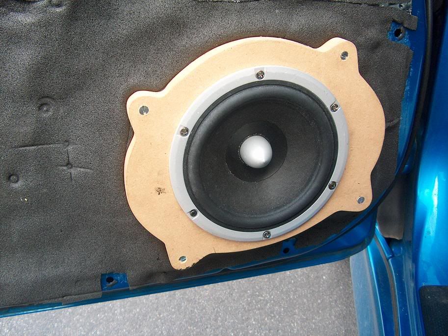

The DRZ9255 is actively crossing over the frequencies sent to the 4 channels of the MB Quart QAA4250.
The front two channels are powering the Seas Lotus Reference Aluminum Tweeters. The rears are powering Peerless Exclusive 7" Midwoofers.
It is incredible. I'm just speechless to say the least. There is so much power and clarity it is insane. The MB Quart QAA is rated for 250 watts rms x 4 @ 4 ohms. The gains and built in crossovers on the amp are all bypassed. The DRZ handles all gain control, bandpass crossovers, Parametric EQ and Time alignment. I am very impressed with this setup. The left imaging is out past the drivers side mirror. The staging is at or 4 inches above dash level. Stage depth isn't that great. After mounting the tweeters in A Pillar pods it should bring the depth out onto the hood.
I need to get a dashmat and start deadening/soundproofing the rest of the truck.
The sad part is I already pulled out the MB Quart amp.

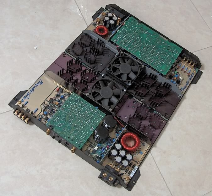

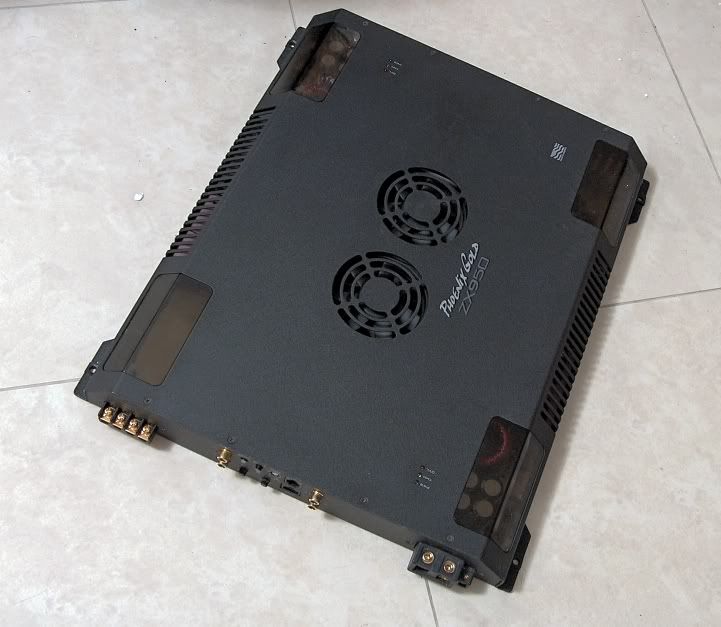

The good news is, I'm trading it for a Phoenix Gold ZX950 6 channel :D
Specs on the PG amp here.
http://www.phoenixgold.com/webfaq/ZX.htm
It's basically a ZX450 and a ZX500 in one chassis. I've read that there are less than 20 of these ever made made in black.
