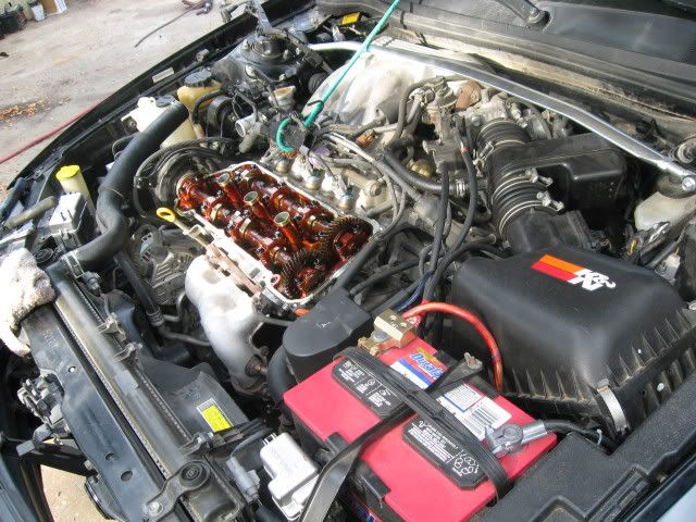

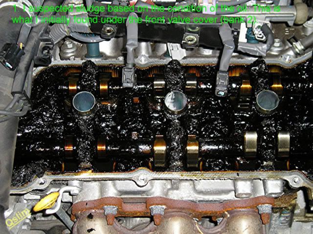

And I was SHOCKED. It was completely the opposite of what I expected. I expected to see something like this.
But...I was so happy to find this:
Yeah, I had to change my valve cover gasket due to a couple of drops I wasn't happy about. (Nothin' bad but they made the front of my block look bad), but besides the motor has 148k on it.
Heres a few pics.
After hearing all that you guys have said about the 1MZ's oil sludge issues...I was impressed to say the least. I'm running AMSoil now and not going back to anything else. I now run it in my J30A1 Accord...I highly recommend it.

Oh gawd, lol... when I saw the first picture, my heart skipped a beat. That was what mine looked like when I had it checked for sludge. Toyota covered everything so all is well now.
You lucked out!

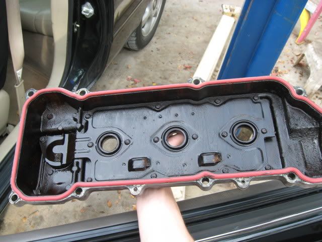

Well, I originally thought sludge because of what I could see when I took the oil cap off, now I know how the valve cover is designed with the PVC breather system. So, the sludge there is normal. After I switched to Amsoil, I noticed some oil from the front of my motor, so I picked up some fel-pro gaskets to fix that. On top of the fact that I was just curious as to how bad it would be. To be honest, I bought this car from my parents too and I know my mother didn't take care of it very well, Castrol 5w-30 conventional since new, all up to 130k. When I got it, the spark plugs were original as well as the fuel filter, the brake rotors were original and so on so forth, since buying it I've changed my fuel filter, rotors, plugs, wires, etc. So theres a few reasons why I started to think about sludge.

Yeah, Theres not really many signs of sludge to look for, just some black looking stuff on/around the edge of valve cover or maybe on sides of cylinder heads. It takes 25 minutes, and about 10 bucks for a good gasket. I opened mine up originally just because I was curious about my sludge. However, do NOT take your valve cover off if you do not intend to replace the gasket. If you remove the cover, but don't replace the gasket I can promise you, that you'll start leaking.
