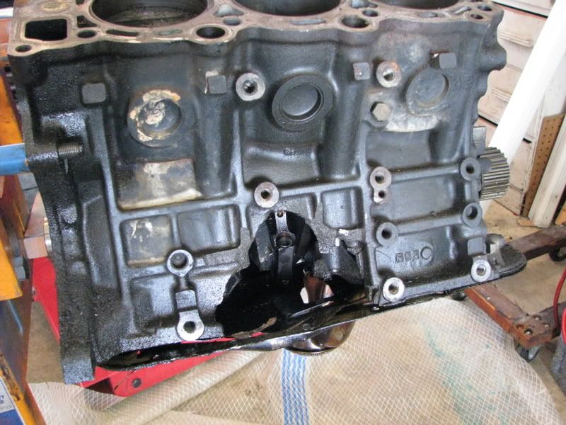

Postby JavaJoe_2 » Sun Nov 09, 2008 9:21 pm
At least it doesn't look like this:
