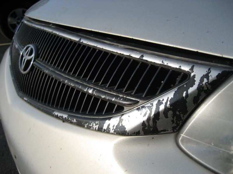

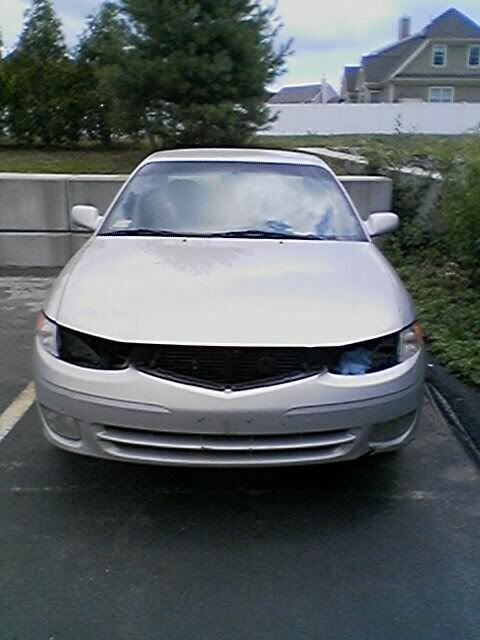

First was the free stuff: took out the headlights to glue some tabs back on and buff them out and repainted the grille...
before:
after:
