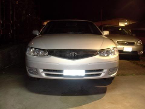

Postby nemoxfishy » Thu Sep 13, 2007 10:07 pm
halo~
try something like this....
how do you think ?
i bent my plates so only the numbers show... then i zip tied it at the bottom opening... i like mine~ =]
nemoxfishy
Posts: 309
Location: BC, Canada
Postby NeFaRiOuS_SLE » Fri Sep 14, 2007 8:40 am
Not bad, but keep in mind that it's still against the law... At least here in Cali but it could still raise an eyebrow.
