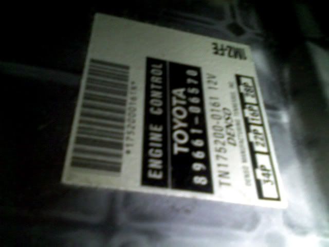

Postby Gibson99 » Wed Sep 02, 2009 9:20 pm
it'll be next week now. i worked tonight, working tmrw nite, and going to austin this weekend. dunno my work sched next week yet tho.
but till then, here's a pic i just took w/ my phone (wasn't sure you could get mms on your phone so i'm posting them. besides - other ppl could use them.
for the visually impaired (yeah, it's a crappy cameraphone pic)
||||barcode||||
*175Z000161N* (not sure if that last char is an N or not but the stars are there on the sticker)
ENGINE CONTROL
TOYOTA
89661-06570
TN175200-0161 12V
DENSO
denso manufacturing tennessee, inc
[ 34P ][ 22P ][ 16P ][ 28P ]
1MZ-FE (sideways)
as i said, this is a non-transponder ECU. I don't have the security light in my tach, and my keys are plain metal - no chip.

Postby TxBmbleBee » Thu Sep 03, 2009 5:40 pm
thats the same code of the two i found on ebay

Postby Gibson99 » Fri Sep 04, 2009 6:21 am
for reference, what's the stuff on your immobilizer 5spd ecu so people know not to buiy that one
and of course we still need to pop my ecu into your car and make sure it starts with it! it should, but you never know...

Postby Gibson99 » Sat Sep 19, 2009 9:53 pm
he had my shop manual. but ya when he put it back on i could easily see how it looked like it was just the end of the crank. the shim is chamfered on all holes, and with a little loctite and dirt in there, it really did look like an extension of the crank. live and learn, eh?
and yeah, we tried putting my ecu into his car. no go. his ecu is indeed 5 plug, mine's 4, and there's no way it'll work that way. now to find an ecu WITH the frickin key that is paired with it. stupid anti-theft devices...
short of jerry-rigging his a/t ecu to make it think it has a tranny attached, the only other alternative would be getting a massive wiring diagram, and a harness cut to convert his 5 plugs into 4. too much margin for error there...
