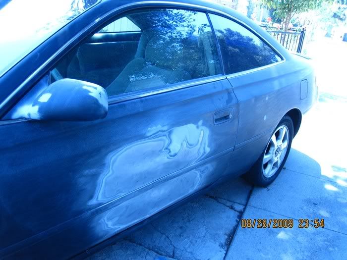

Postby imhappy » Tue Sep 01, 2009 9:53 pm
Image [/list]

Postby imhappy » Tue Sep 01, 2009 10:51 pm
ill take pics tmrw with all the holes , scratches and dents popped out and filled. i have 1000 , 1500 , 2000, and 3000 grit sandpaper waiting.... checked youtube for all my information..... hope it goes well...
i like to make do little projects here and there just to say ive tried something.
thnx for all the advice..... this should be done by sunday

Postby Donnie » Wed Sep 02, 2009 4:34 am

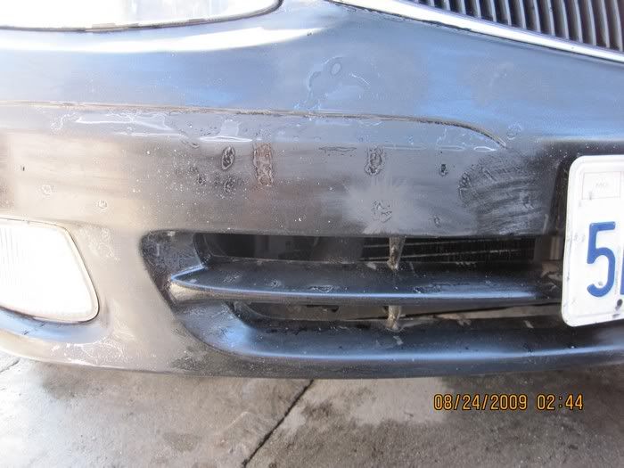

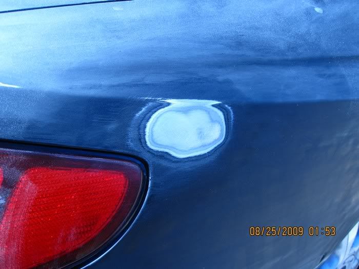

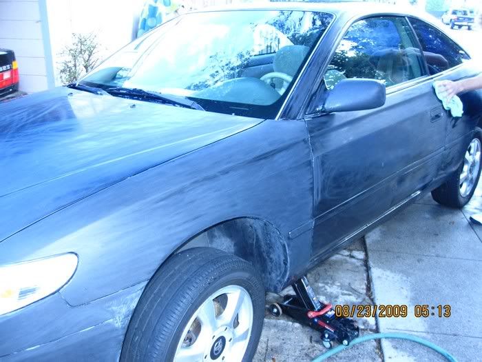

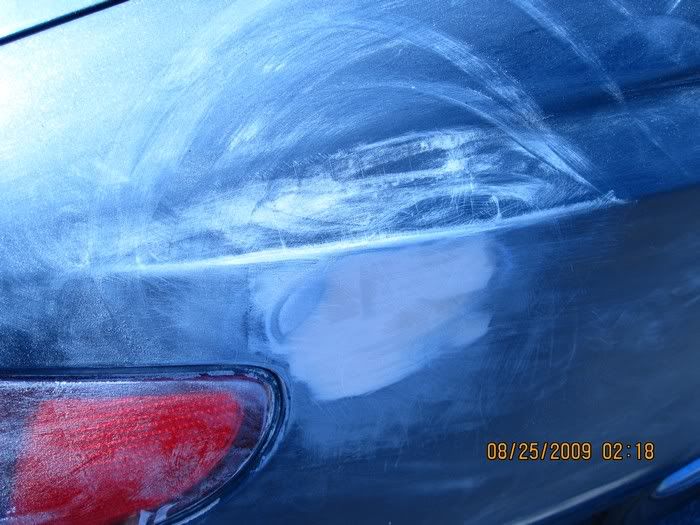

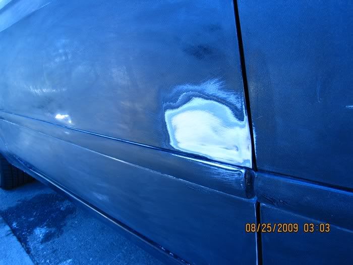

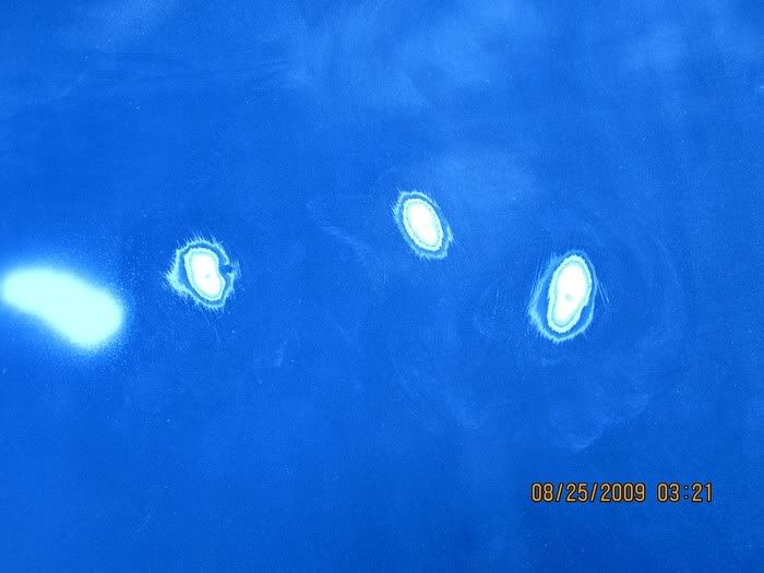

Not to be a smart a&# but you got serious issues goin on here. Every spot in every pic is going to show BIG time.
See on the doors where the paint edges are where you sanded? Your original paint isn't feathering out. Every line is going to show, kinda like you meant for it to. Not only that but you'll be lucky if the new paint doesn't burn those edges and curl up on you.
Even if you use glazing putty on the edges it's still going to show big time.
The front end (first pic) is some serious contaminate in the paint. That's why it's rolling up around the edges of each spot.
Way too many things to point out here, but I'd give some serious thought to having someone do the prep work (sanding, filling etc.) and teach you as they go, then if you want to give it a shot at spraying start with spraying the primer. That'll get you a little more used to spraying.
I saw you already bought your paint. Hopefully you got Base/Clear. The base sprays out really nice and drys really quick. You would almost have to try and make it run to get any runs. The clears a different story. It comes already reduced. All you do is add the activater, but it will run on you if you're not careful.
The base will look like S*$@ until you put the clear on.
Before you even prime, you need to wipe heavily with a Prep-sol wax and grease remover. Then wet sand with 400g. Prep-Sol and then hit the paint.
If your friend told you to use a roller to put everything on......get a new friend. Dude aint got a clue.
I doubt it, but I hope I helped some.
