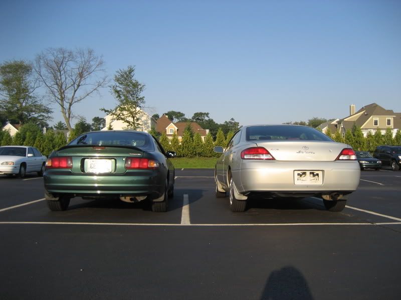

Postby steffknee » Wed Aug 20, 2008 8:02 am
I'm going to try and register it today.
Finally got a picture side by side, it looks so much bigger than my Celica, it's strange.
