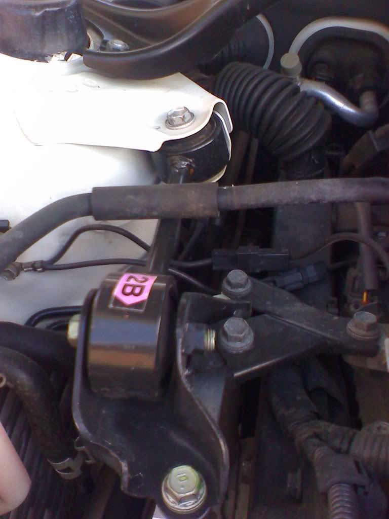

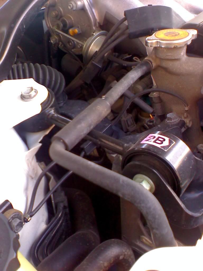

Postby 1gSE » Thu May 22, 2008 11:38 am

Postby SleeperSolara » Thu May 22, 2008 1:04 pm
Looks the same as the auto V6.
