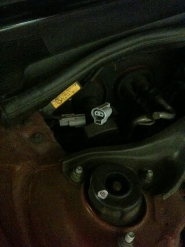

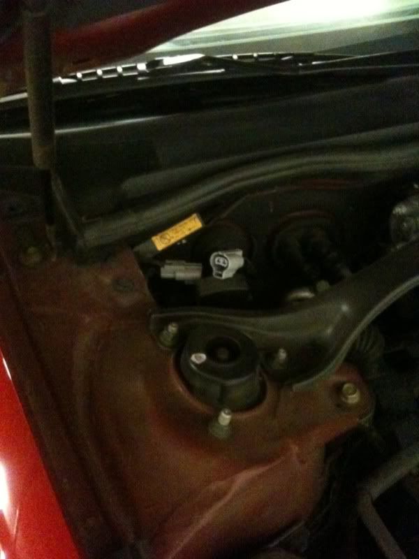

Yoyoyo sorry to gravedig but this thread is so relevantz.
I'm on the same mission myself, I got the sensor on the dash ezpz.
I see the bracket under the hood with the yellow caution sticker. Is the grey plug the one directly in front of it (and attached to the side of the yellow caution bracket?) or is there actually a plug under the sticker that I can't see?

Re: Question about headlights
Postby St.Anton » Sun Sep 04, 2011 1:15 pm
Dude. Dino. You're the man.
I can finally pull up places and talk without stickin' out like ..... a set of headlights at night.
<3<3<3<3<3
