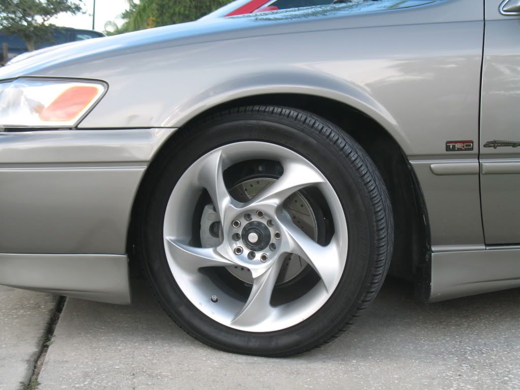

Postby ToyoSolV6 » Mon Jan 11, 2010 3:53 pm
heres mine with 50 series sidewall.
